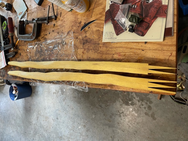

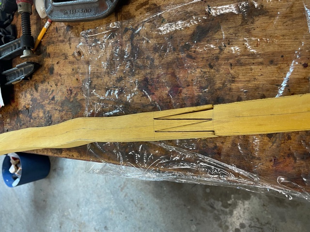

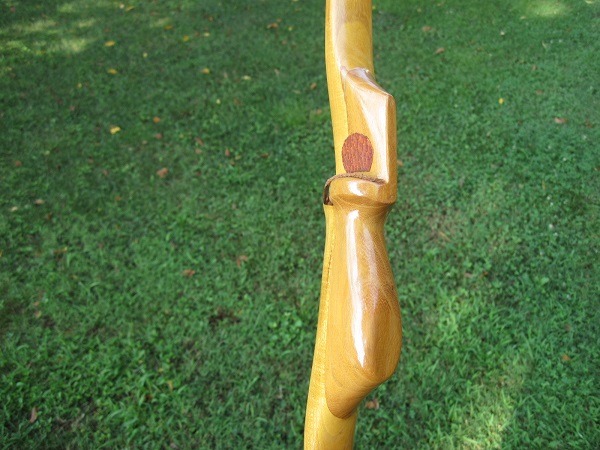

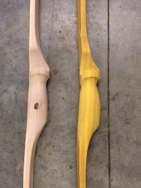

Here's a narrow snakey Billet Osage just getting started. Not determined how long or weight as of now. Will get a grip block ready to glue on. Just finished one thats a little more narrow than this one here
HH~
HH~

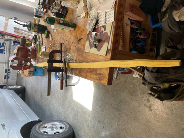

Here is the other snakey bow just finish out of same tree.
Making Amerika Primitive Again - MAPA

Hallo, when I put Billets together I do it with a little reflex (reverse angle) to improve the performance a little bit.

Yes I do some times put backset into the glued joint as well. This bow will get reflexed on a form. Its in the form right now actually. Will glue grip on next.

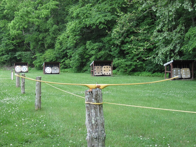

Re: The Hedge is here
Hi,HH,Welcome to the FC.

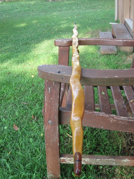

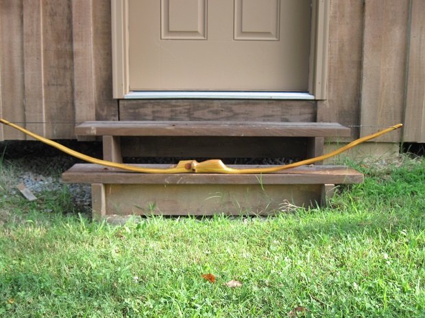

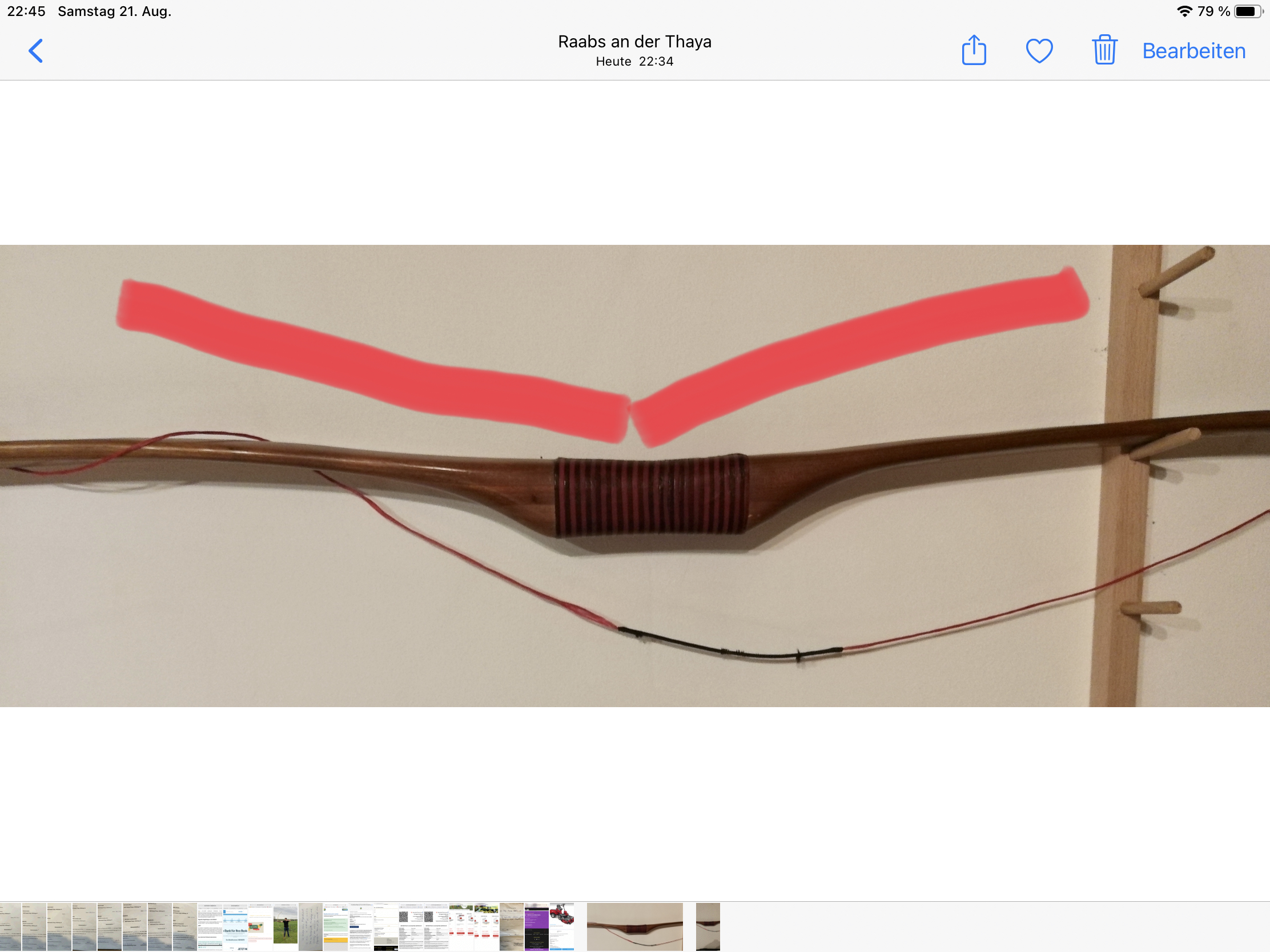

Now to the roots: Your Bows tend too much to bowing grip-near,the outer Limbs are a little bit too stiff, so you get too much Mass Outwards , they slow down
So ,you lose performance,even if the Wood makes it without any Break
,there is too much unused wood...
This is Critic,but none in the way of "Dissing".. You hopefully understand
Greets,
Greets,
So, it might be better,to let the Bow bend on the whole length and not to tend to let the Setback and the .hmmm..maybe...functional..Tiller ..uh... let the thing do....

Hi, Concerning the bending (tiller) of the bow:
I think, if there is no „handschock“ then the bending is ok, if the bow shakes a lot when released then it would be better do remove some wood from the outer parts of the limbs.

I tend to keep outer third stiff on all my bows except on target bows. Lots of people get wrapped up worrying about a perfect tiller.
I am a hunter and use the bow for hunting purposes to feed my house. No hand shock in any my bows I have ever noticed.
