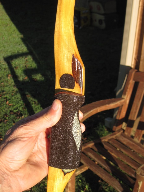

coming right along now. Getting ready for a Stingray leather grip.
HH~

Re: The Hedge is here
I like the way the pattern on the hide resmbling the damage area above. Looks as if it was meant to be.
Yes it is very hard work to debark Osage when it is already dry, next time I know it better.
Very nice grip leather, it’s breathtaking.

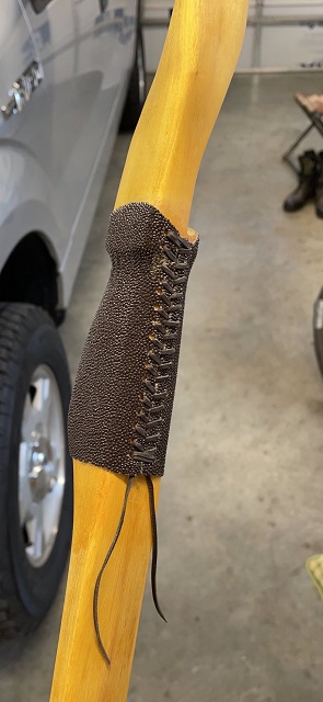

Thank You Kindly. Yes, went with chocolate color leather to match that dark old oxidized part of the stave. I purposely left that old color and did not scrape it off. leather is very hard to mold to a curvy handle but I got it best that could be done. Put a baseball sewing job on it with Kangaroo Lacing in chocolate color as well. Will put the finish on it, strike plate and shelf leather and its ready to shoot.
finished up between sitting in forest with a bow.
Hi, the colour of the back is very nice, what did you use, some kind of wood stain?
Thank you . Rifle stock dye that I mixed colors.
