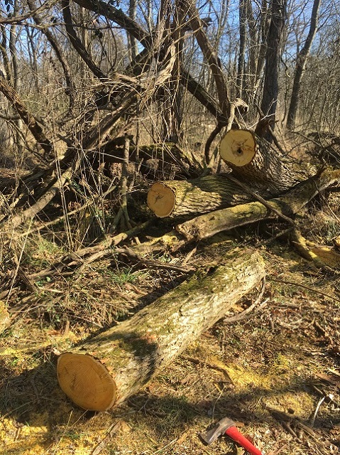

Beitrag von HedgeHunter »
The new 68" Osage cut off my farm is ready for the forms and some straightening. Should make a fine bow for the High Country. Has that nice Orangey color.

Beiträge: 6277
Hat gedankt: 76 Mal
Hat Dank erhalten: 243 Mal
Re: The Hedge is here
Hi, the rings look very thin, do you use the first ring after the sapwood?
Greetings
Thomas
HedgeHunter
Beiträge: 87
Registriert: 19.07.2021, 15:35
No usually never do that. Think I peeled off 6-8 rings on this stave. I dont care much how thin rings are but rather the Ration of early wood to late wood. This one has 50:50 which normally is not ideal but this tree I cut has made fantastic bows this was a big tree. I went down till I found some rings that were hard chase because they were really stuck hard on the next lower ring.

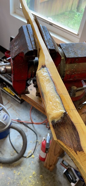

HedgeHunter
Beiträge: 87

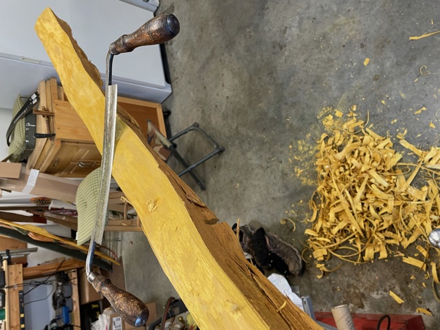

New one getting peeled. Sister to the one above.
HH~

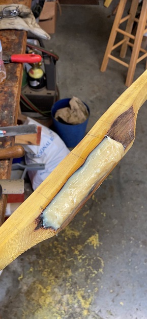

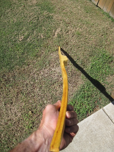

HedgeHunter
Beiträge: 87
Started on a 26yr old piece of Osage. Should make a really nice 68" bow. Wood is very springy. Had to build up in grip area. has a natural sight window for a right hand shooter. Wood is very springy.
Hedge~

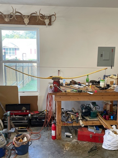

HedgeHunter
Beiträge: 87
First brace on this new Osage. Looks good for a first brace up. Make a very nice shooter. Time for tiller on out to 28"

klausmann84
Beiträge: 519
Hat gedankt: 9 Mal
Beitrag von klausmann84 »
Do you floortiller? I would prefer the limbs to bend more evenly before stringing and tillering. But i work with whitewoods mostly and so i try to narrow down the time when the forces are spread unevenly on the wood. Maybe Osage is not that sensitive in that matter?

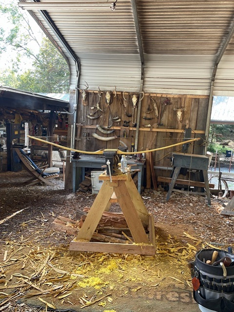

HedgeHunter
Beiträge: 87
Like to get a string on early. Yes, you must floor tiller so you don't have a very uneven first brace. By getting a string on it early with a lot of weight it lets the Osage feel that. Much easier to hit your target pull weight. The bow is reflexed near the tips, what your seeing here is the uneveness of that reflex affecting the profile some what. This is a low brace only 4.5" or so.
In this photo you can see inner third is bending some but mid and outer limb not as much. Will be relatively easy to bring into good tiller without missing bow weight this way.
This is a character bow as it has plenty pin knots and limbs were vertically and horizontally wavy. Had to be flattened then moved left and right. Has ten heat treatments on form to this point. Was worth it for a 26yr old stave of Osage.
HH~

klausmann84
Beiträge: 519
Hat gedankt: 9 Mal
Thanks for the detailed insight on this matter. :)

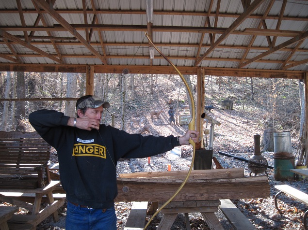

HedgeHunter
Beiträge: 87
At full brace now. Going slow maintaining positive tiller along the way. Brace is 6" and very heavy at this point. Looking good at still holding reflex nicely.
