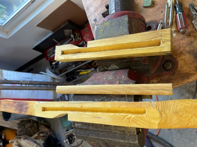

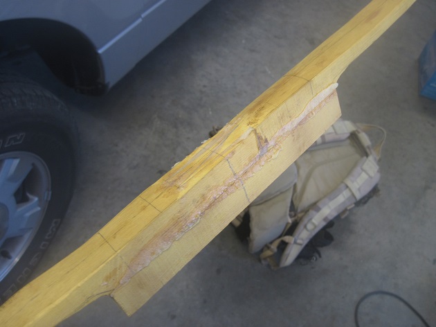

Here is this bows riser/handle section. I had to make a tennon to fit in handle to make in stronger. This is what it looked like before glue up. The small thin peice of edge grain osage was glued into the middle.
HH~

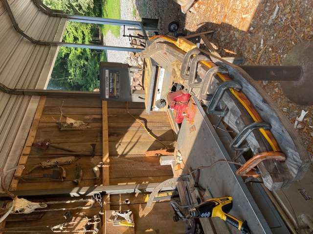

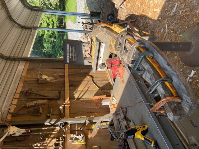

Got his bow ready for the form or caul as we sometimes call them. Will get the limb tips to line up and will add some more reflex to to the limbs today.

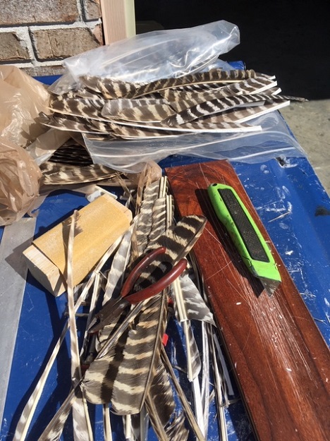

Like to make my own fletching. Getting ready for some new fall arrows
HH~

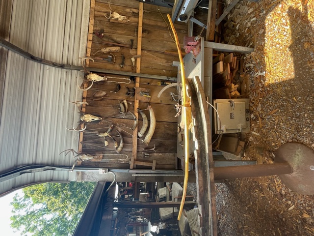

Got this snakey Osage back in the form. Reflexing the limbs one at a time. Should have it reflexed by tomorrow and begin tillering. It will have an arrow shelf and we call them ALB American Longbows. Has to have a shelf for when you hang the bow from a tree son arrow does not fall off.
HH~

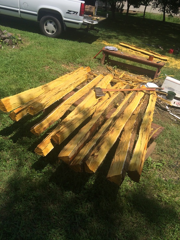

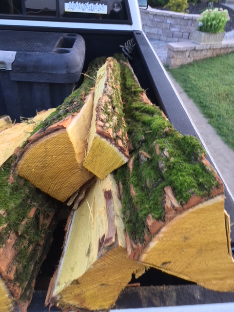

I got plenty bows and a barn full of osage billets and staves. I cut for the years ahead.
HH~

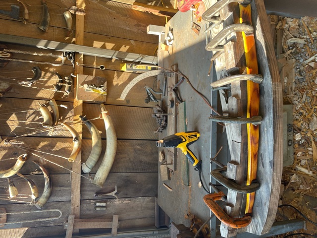

Here this billet snakey bow out of the form. Has reflex in it now. Looks like it will hold some of the reflex after tiller as well.
HH~

Nice pictures. And very interesting handle construction. Have used biscuits on edge occasionally but the big dowel is a nice addition to my kit of methods. Cheers!
Guess you used a router?

That was not a dowel it was an edge grain 8"x.5"x.25" tenon. No, I cut that by hand after ligthly glued riser block and cutting out sight widow. Then , i knocked it off and hand carved the slots for tenon.
Yes this will stiffen up your riser with good two part epoxy and keep vibration out of riser glue lines. When finished it looks just like any other glue on riser for a billet bow but it is much more work. The results for longevity are worth the effort.

Hi, nice Osage Staves. The heat treatment of Osage is very interesting, I am looking forward to know how much of the Reflex survive. Nice pictures, thank you for sharing.
