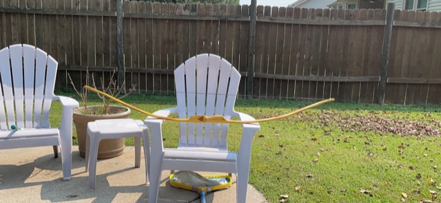

Beitrag von HedgeHunter » 13.09.2021, 15:26
Here it is complete. Ready for the woods.
HH~

Aye,man,quite good looking Bow you made :D
Won't go to more draweight? 45# is ,maybe, not enough for you,i assume. I'm going to my 6ties,and so is my draweight,about 60#+. ;)
As you are ,maybe,much younger than me, I'd like to see some Bows of yours exceeding the "Common Comfort Zone". ;D

Im about sixty. The man who wanted a bow had picked the weight he wanted not myself. Heavy bows are easier to build to me. Very easy to build 60-70lb Osage bows, not nearly as hard as building a very good performing 25lb Osage Bow.
I have no reason to shoot any bow over 55lbs. The are no Mammoths or Dragons left. 8)
