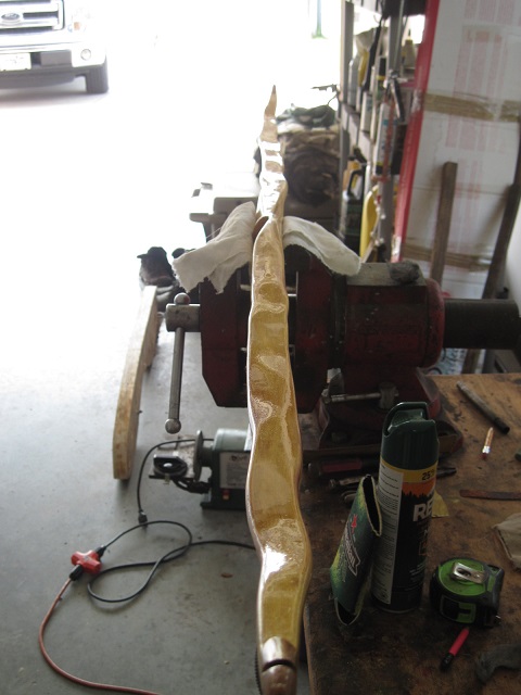

Have the bow out of form now and almost ready to tiller. Floor tiller is complete. Will put tip overlays on it to start the formal tiller process. Looking OK for now. Should make a nice shooter with a shelf so arrow can sit on it while hanging up.

Got tips on bow and have some heat alignment to do as the string is favoring the off shelf side. Should not be very difficult to align the limbs with some heat on the form. then on with finishing tiller. Floor tiller is complete as well. it is 65 inches from sting grooves and 67" overall length.

Hi, are both limbs the same length or is the upper one shorter?

Same length Thomas.
First brace after floor tiller. Still heavy. In no hurry as I have working in forest now.
HH~

This bow is getting last coat of finish today. It has a very interesting date on it.
45Lbs@27"
9-11-2021
It is gong to US Army Combat Veteran from the War on Terror. So, the date will have some meaning for him. Twisted up a nice 8125 BCY string for it and it shoots extremely well 40-45 spine arrows and 145grn points. Bows hols about 2.75" of reflex after getting it shot in.

Hi, the finish looks very good, which oil do you use?

I use a sealer then Tru Oil and usually go with poly over top if it will be in the woods a lot. I have to get a finished profile of this one strung up. Its a killer, shoots flat and fast.

Here it is complete. Ready for the woods.
