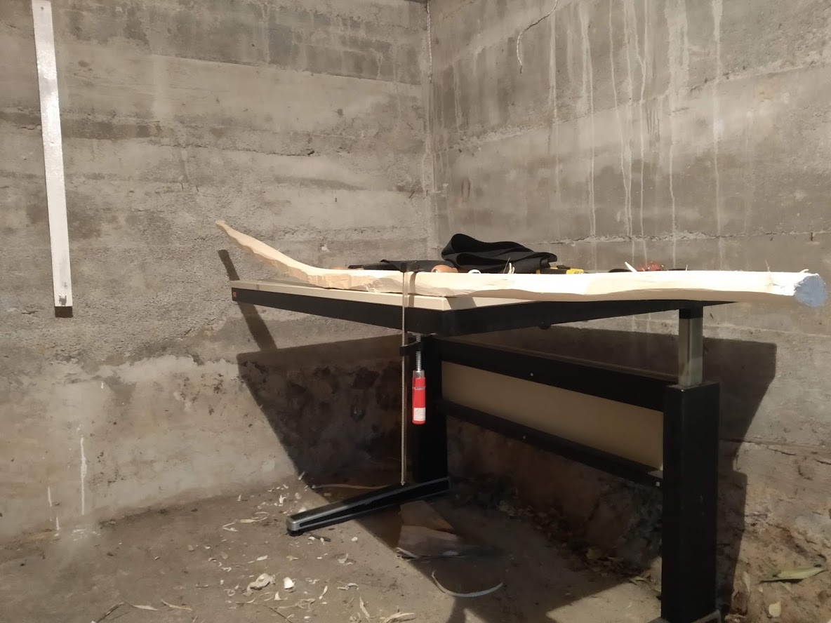

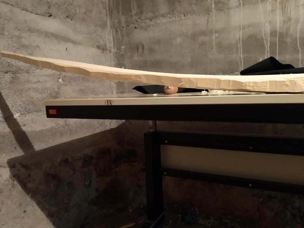

So i have already made a hazel bow, 30# at 28 inches from a better stave than this one.
Im wondering if this stave is usable, it warped a lot during drying.
I was planning to shave a bit more wood and try steam bending it back a bit.
Any recommendations?

What is the thinest part of the side profile in this stave? Not the thickness, the width.
If its not to thin i would shape the straight half of the stave to a clear thickness (around 15mm, depends on what u want to pull at the end) and bend it with steam to the same reflex as the other side. A part of the reflex u will loose anyway in the tiller process.

Thanks to both of you for response.
Im from croatia, and where i live hazel is everywhere, so if it breaks i'll just get a better stave next time
I'm not really going by any measurements, just trying to get anything from this stave will be a win in my book.
I guess i'll get a rough profile in, and bend it a bit.
If it breaks i have a few other hazel staves, this one is by far the worst one so i dont really mind screwing it up
